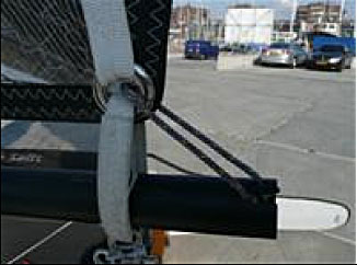

Where could I find the dimensions of the Tiger or other F18 booms? I don't even know how long my stock H18 boom is, boat is an hour away. Anyone have the measurements?
I don't have a Tiger to look at, could someone post pictures of how the boom is rigged?
I've seen the very simple rigging of the Nacra Infusion boom, not sure if a system like that would work since the clew of the Hobie 18 sail is well behind the traveler, so the blocks can't connect directly to the sail like they do on a lot of modern cats.
The blocks would need to attach to the boom with their own strap, then the sail attach to the end of the boom, maybe using the same simple outhaul as the Infusion.
Anyone done anything like this?
