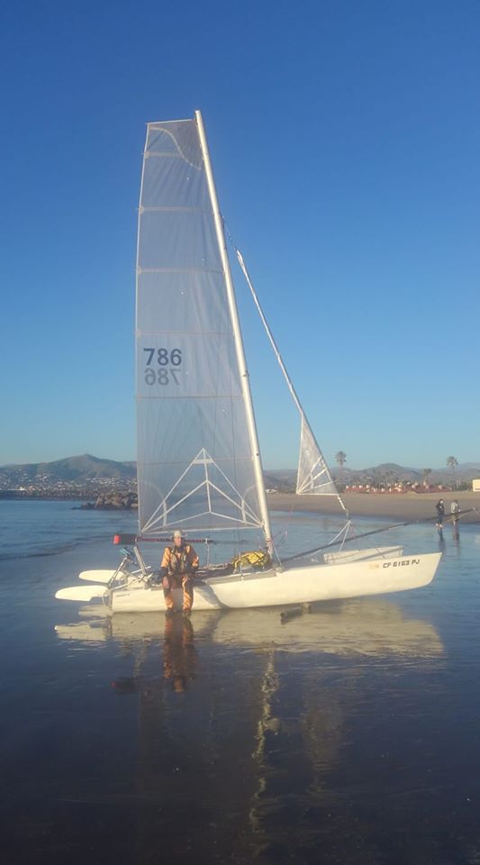

If it is strong enough, you could fashion some lines on it and it may work. I put some money into my system, purchasing a 5 ft carbon fiber tube, then mounting a nylon cutting board to one end to use as a paddle. I don't have any good photos of it handy, but you can see it mounted to the boom in this photo. There is a reflective section of aluminum plate at the end (cut from a road sign I found in a ditch). This slides into the daggerboard well which will be clear later in this post.
I've righted the Prindle 19 once with this pole, which is the Solo~Right design pioneered by Gary Friesen years ago, and demonstrated below. Remarkably, over 20 years ago:
