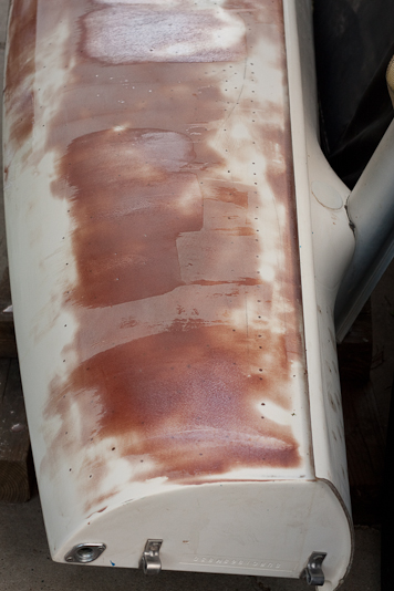

Mike we just did this repair on a prindle 18. We did the normal drill holes then fill with west. Once the area was solid we then feathered more west on the area to bring back the shape. We didn't put any thing in the hull to push the sides back.

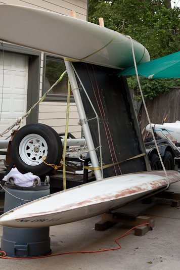

We put hull on its side so the area we where going to be filling was as flat as possible. Because this stuff with settle where ever it will run. We would mix up about 3 pumps and 3 spoon fulls of epoxy at a time and work over the whole hull. That way we could let it set up and do it again if we needed to.

Thank you all for the advice and David for the pictures too. I purchased the West Epoxy and measuring system and tested in large area with hopes the it would work. Unfortunately, i think my hull is too far gone. The entire side of the hull is saggy with the firmness of cardboard. I put about half a litter of epoxy into one area and it didn't seem to help much. I took it out on Sunday and noticed lots of flexing and stressing on the inside of the hulls near where the forstay cross cable attaches. As much as i am up for the challenge of repairing her, i think the time and money would be better put toward finding new hulls or another boat. πŸ™
Thanks again for all the advice and i did take photos of my endevor (using air pressure to bring the hull to form)if anyone wants to see.
