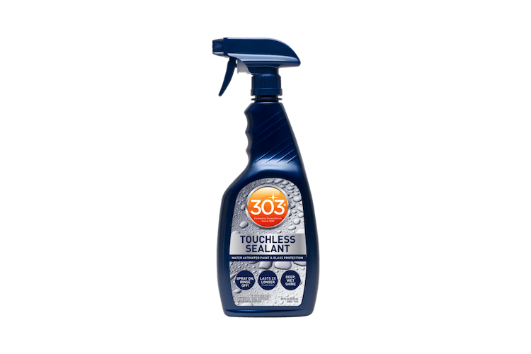

You may want to check out a new 303 "Touchless" spray-on sealant product that should help protect any non porous part of your boat. You spray on onto wet parts and the liquified glass passes through the water and bonds itself to the surface, and thereafter repels water for 6 months. Replaces waxing. Instant, easy and amazing.
https://www.goldeagle.com/product/303-touchless-sealant/
https://youtu.be/PaZXCRShEvc
