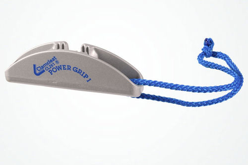

Third option would be to install a quick release clamcleat on the top of the tiller arm. Says you can set resistance to over 500lb, and it will still break away if you hit something. While this is the easiest, and guaranteed to work, I feel like its also a work around. I also fear that when the rudder does pop (as this doesn't address the root cause just the symptom), no matter how tight you cam the rope, weather helm will still develop due to stretch in the line. Certainly not to the extent as when the rudder is up, but will it be enough to annoy me that I didn't just fix it right to begin with.
