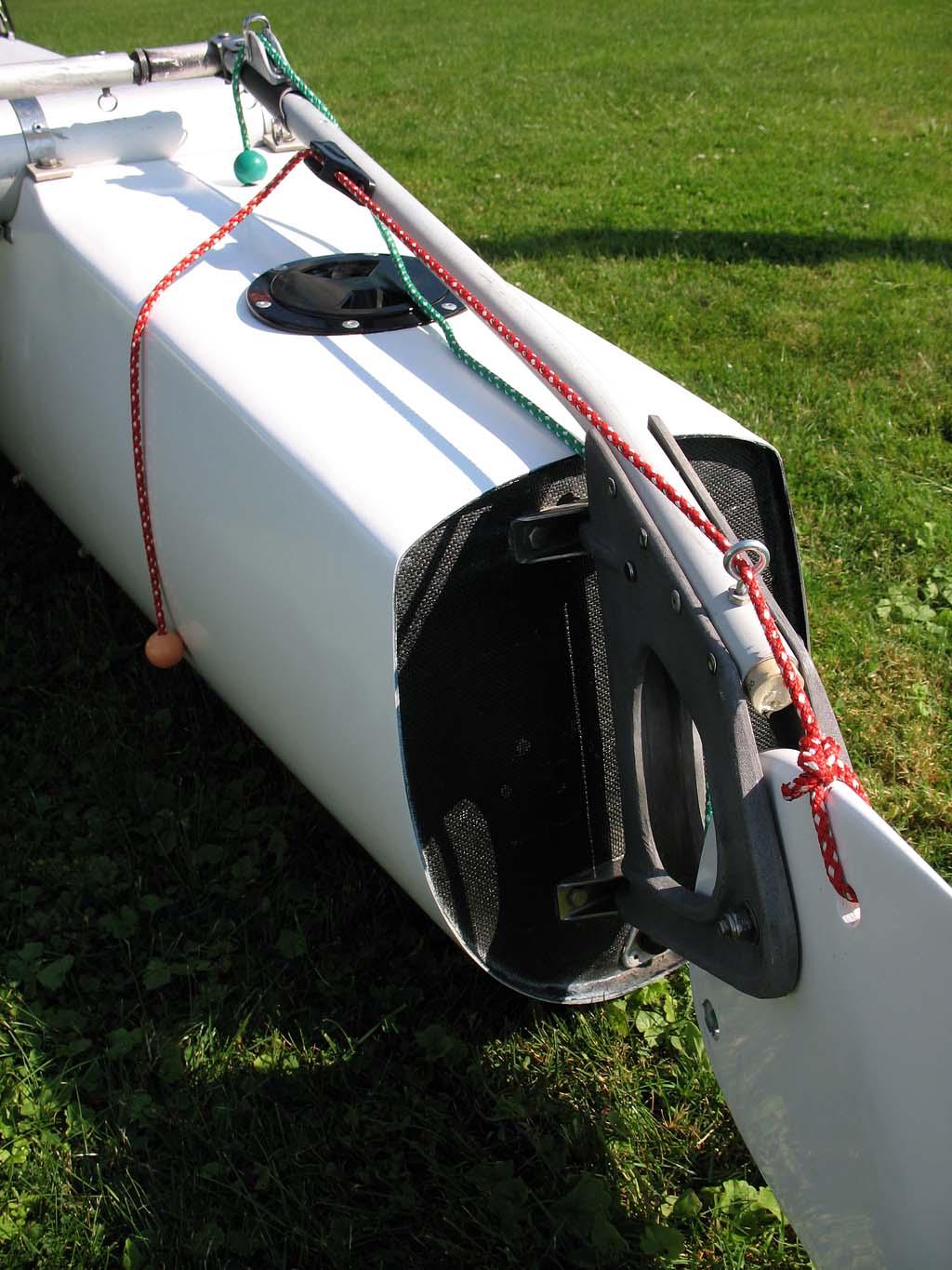

when you release the pull down line it has a tendancy to recleat itself after you let it go, so if the rudder doesn't pop up the whole way it gets stuck half way up. Then I end up draging the rudders in the sand when I beach.
This happens to me as well. I don't have pivmatics, so I have to watch the rudders closely when coming in to shore. I've thought about doing away with the shock cord and using a second 'up' line that I can cleat, but haven't taken that jump yet. Maybe after another season.
It's technique and everything working. If your bungees are strong, when you release the hold down, continue holding for the brief second it takes for the rudder to fully raise. So easy a caveman . . .

My bungees...well..everything on my rudder system is new or redone in some way. Every rivet, line, gudgeon, etc. The bungees basically balance the rudders when out of the water, they're fairly neutral. When in the water they pull them up as soon as the water nudges the rudders back. Of course if the water isn't flowing past quickly its not that critical to get the rudders up quickly anyway.
So, like I said, I can't just pop the line up, or it'll catch again, and without the pivmatics it'll jam if it hits the sand. I hold it up for about a second then throw the ball on the end of the line towards the rudders so it doesn't catch. I try to come in to shore sitting right by the leeward rudder with both daggers and the windward rudder all up.

The elastomer cord workes fine haven't had an issue and it is more durable than shock cord. I think that the tiller upgrade kit is pretty pricy although a lot of people swear by it. Try using a new stainless Nylock nut on your system, that is why I have on mine and it hasn't worked itself loose yet. I have had both the H16 and Nacra systems and in the end I prefer the Nacra. It has less parts, is dead simple and never accidentally unlocks itself.
Rob's advice above is good, hold the rudder line for a second so it doesn't recleat and throw the ball aft so it doesn't recleat. If you have the Pivmatics and it does recleat it isn're really an issue. You also have to remember the the shock cord doesn't hold the board in a locked up position, it just brings it 2/3 of the way up and the board bounces there and moves if it hits something. If you want a more positive locking system you can try this upgrade here:
but it is more fiddly than I like and more things to worry about as you are beaching.

i try to beach without using the pivomatics at all, hate the idea of smacking the rudder tips all the time and what might happen if they don't come up
releasing the hold lines while coming in was ok but then dragging the boat backwards up the steep foreshore was difficult with the rudders dragging in reverse
so added extra cleats and lines to hold the rudders up, works very well
they have next to no load so you only need the cheap plastic ones. but if you wanted you could buy alloy ones and use them for the hold down cleats. then your old hold downs could be the new hold ups

Basically it just puts tension on the rudder so when you uncleat the downhaul it just pops up. Here is the page from the manual:
