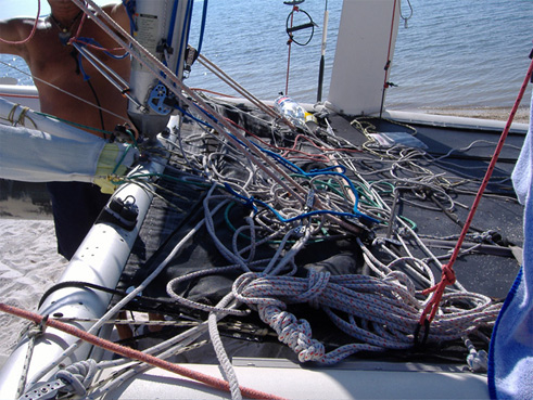

(@damonadmin)
Posts: 3521
Admin
I was going to send you these photos but decided to start a technical album with them. Anyone else that has a setup, especially for "classic" beachcats that didn't originally come with a pulley based downhaul, please share.
Album is at
https://www.thebeachcats.com/pictures?g2_itemId=128883
I've started it off with my setup.
Here is how Kirk at Key Sailing setup my 8:1 double exit on my Hobie 18.
This setup solves the problem of having so little space between the foot of the sail and the rotator as well as below the rotator to the mast base.
The double exit is just a bonus, making it easier for the crew (or me solo) to find the downhaul line. I only wish my line was pink or something (pull the pink line!).
Only downside of this setup is it's permanent, and you have to rivet into the mast.

(@randii)
Posts: 139
Mate
Damon, thanks for the gallery. Your mast illustrates how many things fit together into little space. Taking the exit blocks that far forward helps move some of it to the side and away from the gooseneck.
Sidenote: is the light blue rope coming up center-of-tramp just aft of the front crossbar your righting line?
If I put together more DH, I’ll probably try to reuse the single stainless steel exit block I have… otherwise I’d have to buy TWO new exit blocks, since one being SS and the other being black plastic just wouldn’t do! 😆
I’m hearing loud and clear from experienced folks that I’m unlikely to be playing the DH on an H18 that much, anyway. My crew or I can probably do it as we cross on a tack…
I’ll put the box of bobs, blocks, and bits aside for now, and just go sail what I have… I’ve got a bit to learn about how the squarehead will open up (or not) based on various existing controls.
