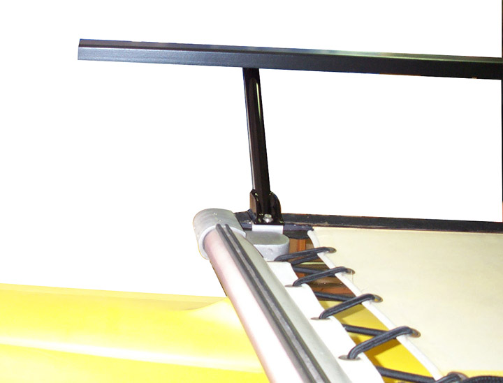

Since Revintage brought up a picture of our Inter 20 wings on Team Ketch Me if you Can for the 2017 Race to Alaska (facebook team page here), I figured I owed some more details on our wings and the research we did -- I had promised to do this a while ago but didn't get to it since the race in June...
First off, it's fair to say there are many ways to skin this cat, both looking at production and custom designs. Below are just some of the inspirations we used - I thought it would help to have them all referenced in one place.
(1) Hobie has various styles: see descriptions here and here (don't miss p2). Good pictures of a "Classic" Hobie 18SX wing assembly here. Note: this is older Hobie wings from Hobie sailing heyday, pre-Hobie Getaway era (short stubby wings).
(2) Nacra/Prindle wings: see on CatSailor here and here -- these look pretty flimsy to me (unsupported fore & aft, no upwards support via halyard, all loads concentrated in beam ends)
(3) Mystere 6.0 custom wings: see discussion on CatSailor (good info on Hobie wings too) and pics on this forum here
(4) M32 wings: see pics here and here
If you google "wings" on TheBeachCats, CatSailor and HobieForums, you get a lot more details, but it helps to know what to look for. The above cover a lot of the most common styles.
Edited by southstars2012 on Nov 15, 2017 - 03:50 AM.
Posted : November 14, 2017 9:48 pm
(@southstars2012)
Posts: 40
Lubber
Now in terms of the custom wings we built, here were the key parameters of our design:
- Seat style: we went broadly with a Hobie Comfort seat style
- Beam/hull supports: we went with M32-style supports, as revintage pointed out. These are similar to Hobie 18SX wing supports in terms of overall load distribution (a compression/downwards load on the beam end + a tension/upwards load 6-12'' inwards from the beam end). The M32 style seemed easier to make, and sturdier overall vs. the slim support strut tabs and attachments on the Hobie 18SX wings (though admittedly the later are battle-proven). A critical consideration in favor of both styles was the ability to swing the wings up (at dock or if beating upwind in heavy airs where we wouldn't want the leeward wing dragging).
- Mast wire support: to distribute loads further, we reused old trapeze wires to support the wings from the top in two places (near the front beam, and and about 2/3 between the front beam and the aft beam). We tried to distribute the loads about 50:50 between the beam/hull supports and mast wire support. Perhaps we should have put more load on the mast, because we still broke one of the rear beam connection points... (but were able to jury rig it and continue using the wing, though more gingerly)
- Fore-aft support: we had none. That is not uncommon (see M32 wings, and early H18SX wings for example), and felt ok for our use case (one time race). But I would agree that for long duration uses/cycles it would help to support the wings fore-aft. Hobie later added this to the H18SX with a small strut going from about 6''-12'' behind the rear beam and then going forward to the primary wing support strut (see picture here)
- Primary support struts: these are the large posts that go from the beam to the wing itself, and incur most of the loads. The main decision here is whether to go straight (as we did, also mostly on the M32) or with a curved beam (as on Hobies). A curved beam enables a fully-flat seat, while the straight struts mean the seat is always inclined (and more so if you're lifting a hull). While flat may be best for beer can sailing, the inclined seat felts very safe (little change of you falling backwards out of the seat!).
Posted : November 14, 2017 10:23 pm
(@southstars2012)
Posts: 40
Lubber
Finally, I'll go through a few of the materials decisions we made. Probably more to detail I can share later if people are interested, since the devil is in the details (as often). Keep in mind these wings were not battle tested over time, so better material choices could probably be made with more testing.
You can see more pictures of our wings on our FB photos album here, and in this YouTube video here.
- Main wing outer tubes and primary support struts: aluminum 6061 T6, 1.75'' OD, 1.50'' ID (0.125'' wall thickness), weight 7.5lbs/10ft, estimated section modulus 0.242 inches^3 (higher is better). That was what we could get from a local metal wholesaler.
We used 2x 12ft for the outer tubes, and 4x 3ft (approx) for the primary support struts.
Note: Hobie wings are same alloy, but 1.875'' OD, 1.71'' ID (0.083'' wall thickness) (according to this thread), weight 5.5lbs/10ft, estimated section modulus 0.200 inches^3. So ours were heavier but sturdier than Hobie wings, which felt reasonable given the I20 beam to beam distance is longer so the wing tubes need to carry more load (8.6ft vs. 7.1ft on a Hobie 18).
- Wing inner tube (inboard seat tube): a bit smaller/thiner than outer tube to save on weight, 1.50'' OD, 1.37'' ID (0.065'' wall thickness), weight 3.5lbs/10ft, estimated section modulus 0.101 inches^3. This doesn't take a lot of point loads (the netting distributes the loads nicely, and most of our weight was on the outer tubes anyways), so maybe could have even been downsized further. In contrast, Hobie 18SX wings have the same size for inner/outer tubes.
We used 2x 10ft for the inner tubes, cut down to size (approx 8.5ft each).
- Wing fittings: we used off-the-shelf "Hollaender" (aka SpeedRail) aluminum railing fittings wherever possible.
Specifically:
*4x model 41-8 flanges (here) for connecting each primary support strut to its beam. The flange swivels, allowing the wing to be raised.
*4x model 5Ext-8 tees (here) for connecting each primary support strut to the main wing outer tube. In hindsight, we could have tried the similar but lighter weight 5-8 or 5E-8 tee models (we chose the EXT model because it would better distribute the point loads at the end of the support strut)
*4x model 17-8 adjustable tees (here) for connecting each secondary support strut to the primary support strut
*4x model 5-7 tees (here) for connecting each wing inner tube end to the primary support strut
In hindsight, we could have gone with -7 models (Schedule 40 1.25'' pipe, i.e 1.72'' OD) rather than -8 models (Sched 40 1.5'' pipe, i.e. 1.94'' OD), to save on weight. With the -08 models we had to custom machine some metal rings to bridge the gap between our 1.75'' OD tubes and the 1.94'' fitting sizes, whereas with the -07 models we just needed to shave off a bit from the fittings in the workshop to get the 1.75'' OD tube to fit the 1.72'' fitting sizes.
- Custom beam plates: to attach the primary support strut to each beam, we custom-made and riveted 1x flat metal plates into the beams about 5-6'' from the beam end to distribute the loads, and then screwed in the 41-8 flange into each plate. This would allow us to remove the wings, while keeping the riveted piece in place. Because the rear beam's main track creates a protuberance, we had to work around that (see here). The rivets on one of the rear beam plates did let go, so we clearly didn't get everything right (it seems one of the secondary support strut slipped, transferring all the load onto the primary).
- Secondary support strut "feet": we made some rubberized pads to help the secondary support struts distribute the loads on the beam ends (and to prevent them from moving). We probably should have found a way to pin these struts in a fixed position to avoid them slipping at all.
- Wing seat nets: we used some old Corsair F31 trimaran nets and cut them down to size by hand, lashed with dyneema.
- Additional "safety" nets (lifeline netting): we added these to make sure nothing could be dropped overboard between the hull and wing.
Total cost: $500-600
- $190 for aluminum tubes
- $210 for aluminum railing fittings (those add up fast, $12-15 a piece)
- $40 for lifeline netting
- Some miscellaneous parts amounts for custom beam plates, screws, metal rings, dyneema, etc
- Wing nets were free
- Labor was free (access to metal workshop)
Total weight: approx 50-54 lbs (vs. 58lbs for Hobie 18SX?)
- 33lbs for aluminum tubes (cut to size)
- 13lbs for aluminum railing fittings
Posted : November 14, 2017 11:47 pm
