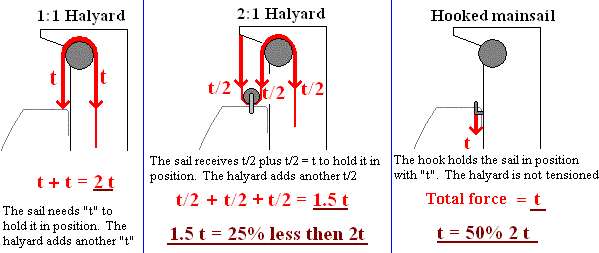

jeff96 wrote: I removed the halyard hook, put a block on the sail to give 2:1 purchase (to reduce mast compression and bend). The Spectra halyard is just cleated off near the base of the mast
gotcha - but at full hoist (assuming the 2:1 is at the head of the sail) the 2:1 doesnt spread any load ?
Posted : February 3, 2020 11:01 am

Half the load is carried by the short length between the dead end and the sail head block. The other half is carried by the halyard running down the mast
Posted : February 3, 2020 11:09 am
(@MN3)
One Star Admiral
jeff96 wrote: Half the load is carried by the short length between the dead end and the sail head block. The other half is carried by the halyard running down the mast
I believe it is 1/3, 1/3 and 1/3
2/3 are spread out or applied to the "above the head" area
but i think the take away is at full hoist the mast compression would be only t (1/3rd the mast compression vs double without the system, or 50% with the hook) Edit: this is wrong and confusing:jeff96's compression is 1.5 t .

attaching main & jib halyards to 2 large chrome cleats i affixed to nere bottom of mast ... puts too much stress on the mast!
how much is too much is the real issue:
it is well documented and agreed that (see chart above)
[list]
  • hooking the head of the sail at the top of the mast = t (or standard/stock compression - see above)
  • securing a halyard around a turning block and back down the mast doubles the compression on the mast (2t)
  • using a 2:1 in your system =1.5t or 150% of the hooked head
    so sailing around cleated on the bottom of the mast is double the compression on your mast. put that in med/heavy air with 2 or 400 lbs on the wire and you are pushing your mast hard (again how much is too much is the real question)
    using a 2:1 add's some compression (50%). spread out in 3rds. If you have reduced sail area /lowered the sail down, (thus reducing the forces on the sail) the 50% increase in compression shouldn't be that severe since the forces on the sail have been reduced
    Edit: I think jeff96's solution has increased compression and not reduced forces when sailing fully hoisted but not certain of the actual physics since a maj of the load is slammed to the top of the system.
    because both main halyard and jib halyard are "hooked" and you cant release them when underway and if hit by a sudden squall or less u r SCR WED!
    I'm not sure what system you think I have. I use the 2:1 that you have sketched a few posts above. The compression force isn't going to jump higher if the hoist is fully up or down to a reef. The physics remain the same.
    my questions are about where the actual loads are spread out when your sail is
    a. off the hook but fully hoisted like your set up and
    b. where the loads are when the main is reefed and the 2:1 has a few feet of line in it
    sorry for any confusion: math makes my head hurt
