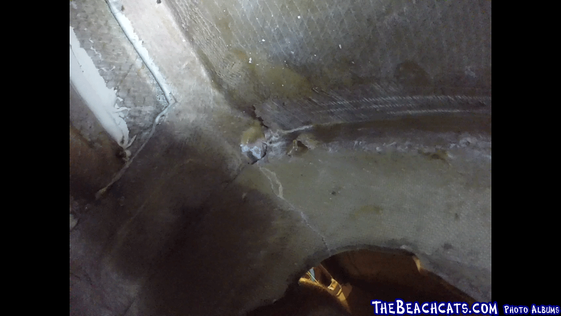

Last night I took some pics from behind the bulkhead that is directly under the beam
we had to cut holes into this bulkhead 6 years ago to gain access to the side stays.
at that time (under advisement) I used some epoxy and "sealed" the lip of the cut so water could not get in.
It seems I should have replaced the cut out or glassed over it as it has now developed "lightning bolt" style cracks that are all coming from(or going to) the area we cut out.

Posted : July 27, 2016 3:22 am

I am glad i found out the bulk heads were so blown out - i should have kept a better eye on them (they have ports close) - the forces trying to rip apart these bulkheads is immense.
