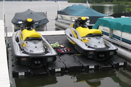

Sold a P18 to a guy out of Hot Springs, AR, he paid me to deliver it and put me up at his lake-front cottage. He had the same problem, 2'-3' bulwark at the waters edge. He wanted to store the P18 mast up at his jetty but I had to explain to him we don't moor cats out on the water. The solution - a floating jet-ski dock. If you see one around your lake, check it out, the double jet-ski dock worked out perfect, the 2 depressions for the jet-ski hulls were almost exact fit for the P18 hulls. Boat is stored up on the dry, mast up, enough floatation for P18 and 4-6 adults.
http://www.jetdock.com/
Edited by the-renovator on Dec 05, 2012 - 12:19 PM.
